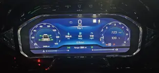

Here's the stats after my first tank of gas post muffler install. Kind of disappointed it made more than 8 mpg.........gonna have to work on that!
Your muffler will not have that impact on mileage. Actually, it will have about ZERO impact on mileage.
You've never driven with me and a new muffler with sustained rpms at 3500 to 5500 rpm.......lol
@securityguy you’ve got this place on lock down, nothing slips past you, fitting handle my man. However, I’m with @AXE i can guarantee a muffler impacts my mileage, at least for a while 😅😅😅
