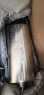

i just received my new setup. its a touring muffler and a new shorter front pipe. gonna find out on monday.I haven't actually used that exhaust tape, but I think some of it goes on soft and then hardens with heat. If you have enough room to take a couple wraps, then slip the pipe over it and clamp it down. It might not look too bad.
An exhaust shop should have flaring tools to make both ends shaped to match better. That would probably look cleaner if you don't want to weld it.
You will like it. When I bought mine back in January all I saw on the Borla site was the "S" & the Attak. I like my "S" though.i just received my new setup. its a touring muffler and a new shorter front pipe. gonna find out on monday.![]()
That’s too long for us to wait. Slightly louder than stock is all I need.i just received my new setup. its a touring muffler and a new shorter front pipe. gonna find out on monday.![]()
Third times the charm!i just received my new setup. its a touring muffler and a new shorter front pipe. gonna find out on monday.![]()
