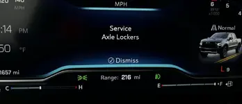

Got the the service Axle Locker warning notification, 22 ZR2 with over 10000 miles on it, and am glad to read that am not alone, all the previous experiences, and am hoping with a little pointers from the post in the past I can help my dealership to get to conclusion faster as to what happened.

Has anyone seen this message "Service Axle Lockers"? Just came on today, it only activates on the dash as I am braking and under 5 mph. Is this a common issue?
