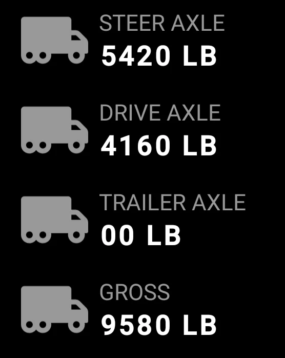

My truck weighs 9k+ lbs the way it sits and I've weighed it on the scales. It rides like a dream whether I'm offroad, city traffic, highway, towing light, towing heavy running at 50-65 psi cold. Ive run as low as 15 psi offroad.

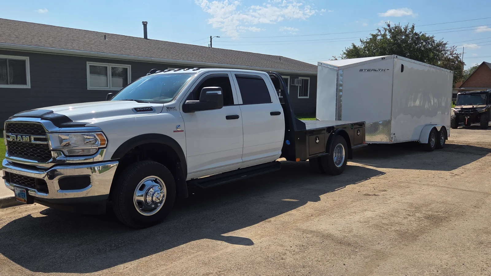

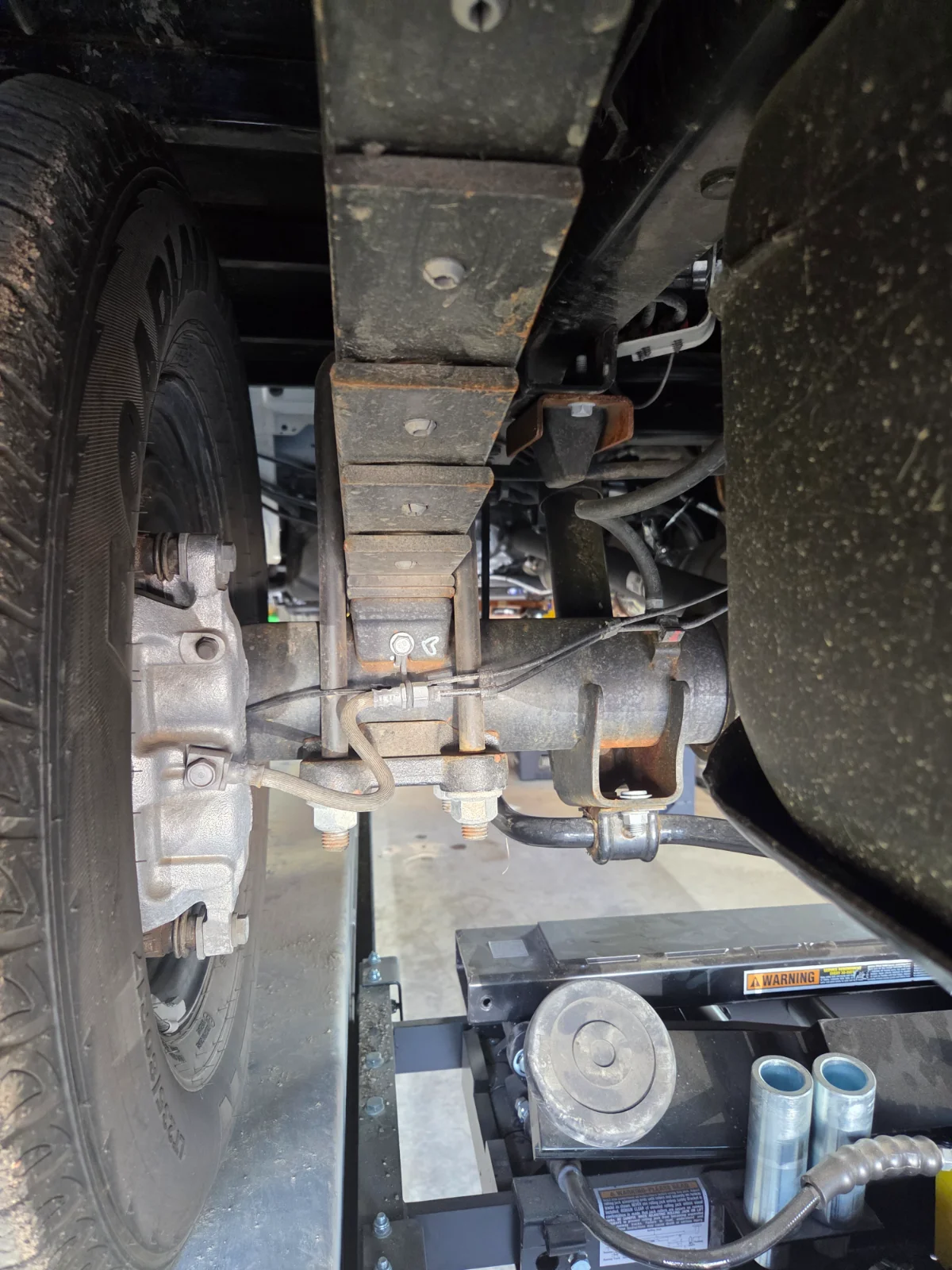

If you want more payload in something that rides exceptionally well, you check something like this 3500 Ram. You should see the spring pack and the front coils on on this bad boy. You rough rider guys would be scared of iron that big. Nevertheless, I was really surprised how well it rides and you can rail it in the corners with those duals loaded down. Not as good as the ZR2 on choppy stuff, but otherwise an incredible ride for a work truck with substantial payload and towing capacity.

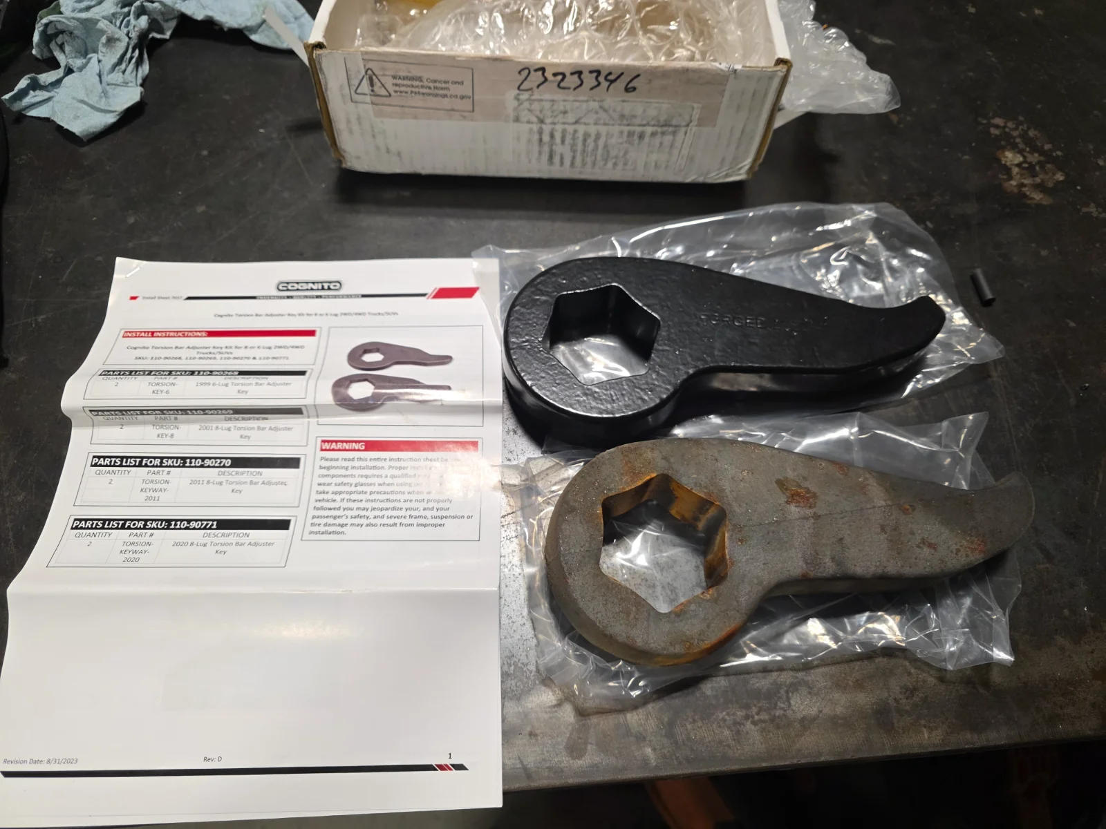

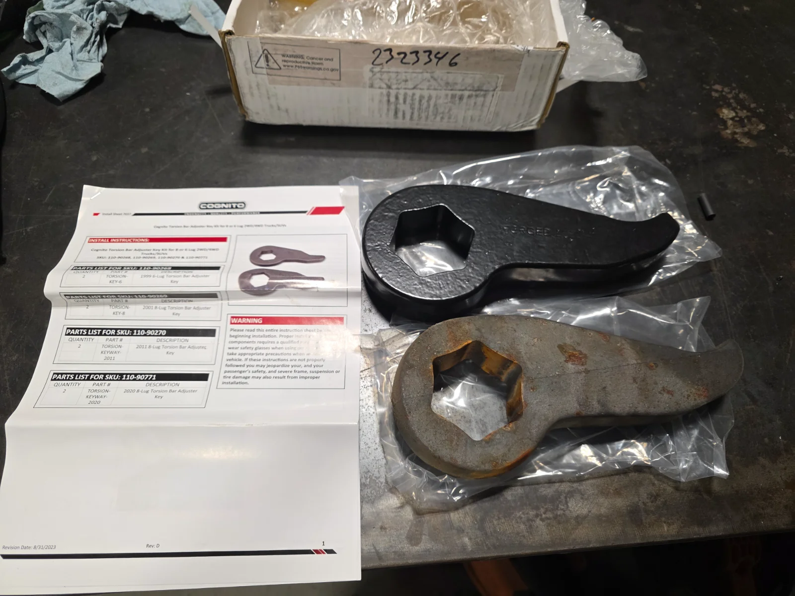

BTW Cognito did get back to me. They said to use these keys, Part#110-90771. I got around to swapping them out today. I actually had to back the bolts off more then the original bars and keys for the same ride height. So with these keys you definitely don't need to crank them up more over stock. Haven't drove it that much, so can't say if they make any difference. They look pretty compared to stock though 🤷‍♂️ , lol.
i swapped bars and keys yesterday. i set the adjuster bolts at the same length as stock. measured ride height after driving a bit. truck was sitting about 3/4" higher than stock. knowing that each turn of the bolt equals about 1/4" ride height on the lighter weight bars, i lowered the bolts 3 full turns. unfortunately, on the passenger side, the bolt then did not have enough thread capture to be secure. basically the key was resting on the adjuster block.
so i had to reinstall the factory keys and adjust accordingly. the bolts definitely had to be cranked more to get the truck back to stock ride height. will see how it rides today.
Wow, my bolts weren't out that much. Stock keys bolt threads were 31.31mm, passenger was 39.66mm. With the new keys my measurements changed to 37.65 Dr and 46.25pass. Not sure how many turns, but about 7mm worth of threads. I just used calibers to measure instead of counting turns. You sure you have the same keys? Maybe its just cause its so new. Might settle a little with some miles? That's the keys cognito told me to use with their bars on a ZR2. The new keys did help in my case. It does ride better then with the stock keys turned up.
same keys. my starting measurements were about the same as your ending measurements. but those gave the truck about 3/4" lift.
