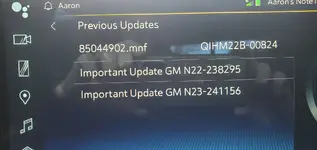

What information shows up in your update list in the infotainment system? Trying to match it to something in nufan's update list. Nufan and I have the same 85044902.mnf update in infotainment system, but mine was done last December. It didn't seem to work on my rig, so not sure that's the right update.

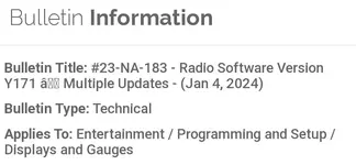

My service advisor gave me the following information. Latest infotainment update 23-NA-183 was January 4, 2023. So I definitely don't have that one.

So I did see that 23-NA-183 number in a Reddit post from a month ago and the guy claimed it fixed his problem. I guess we'll still have to prove it out with multiple vehicles over at least 3 to 4 weeks.

Seems like looking at everyone's updates that the most recent update is packaged in that .mnf (modal neutral file). They must update that file each time a new version is pushed out.

You are correct. The individual updates in the "Previous Updates" section that start with GM NXX are only for updates performed via OTA. The .mnf file is a compilation of several updates either in the radio at the time of manufacture or what it was updated to when the dealer did a hard update while at the dealership. The file I have in my radio now is the same one in post 267 that @Aaron posted.
I would like to state that the latest update I received (same as what @Aaron and @nufan78 received) is a TON better than before. It's now only cutting out for about the first 30 seconds tops for very short periods of time...maybe twice for like a second each and then it's gone. That may have something to do with data still running across the bus while the units still fully booting up. Not the fix we are all now waiting for, but it did make a huge difference to me so I am pleasantly surprised to say the least. This is proof that it is not a hardware issue, but a software related issue. Hopefully, the next update is the charm and problem resolved for us all!
App screen>settings app>updates>previous updates
Then click on any update for more info.
