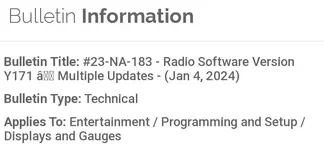

Just got my replacement radio installed. Running the latest .mnf file with an update of Feb. 5, 2024. The latest SPS and USB file numbers are below which appear to be newer than what was posted in the past.
I was interested now that you have a new screen installed do you have the new 2024 ZR2 splash screen at start up?
Those 80YZ are unique to every vehicle and are never going to be the same. They are essentially identification numbers assigned to confirm that the update was installed.
The actual update would be in the bulletin #23-NA-XXX and should have an update reference number.
